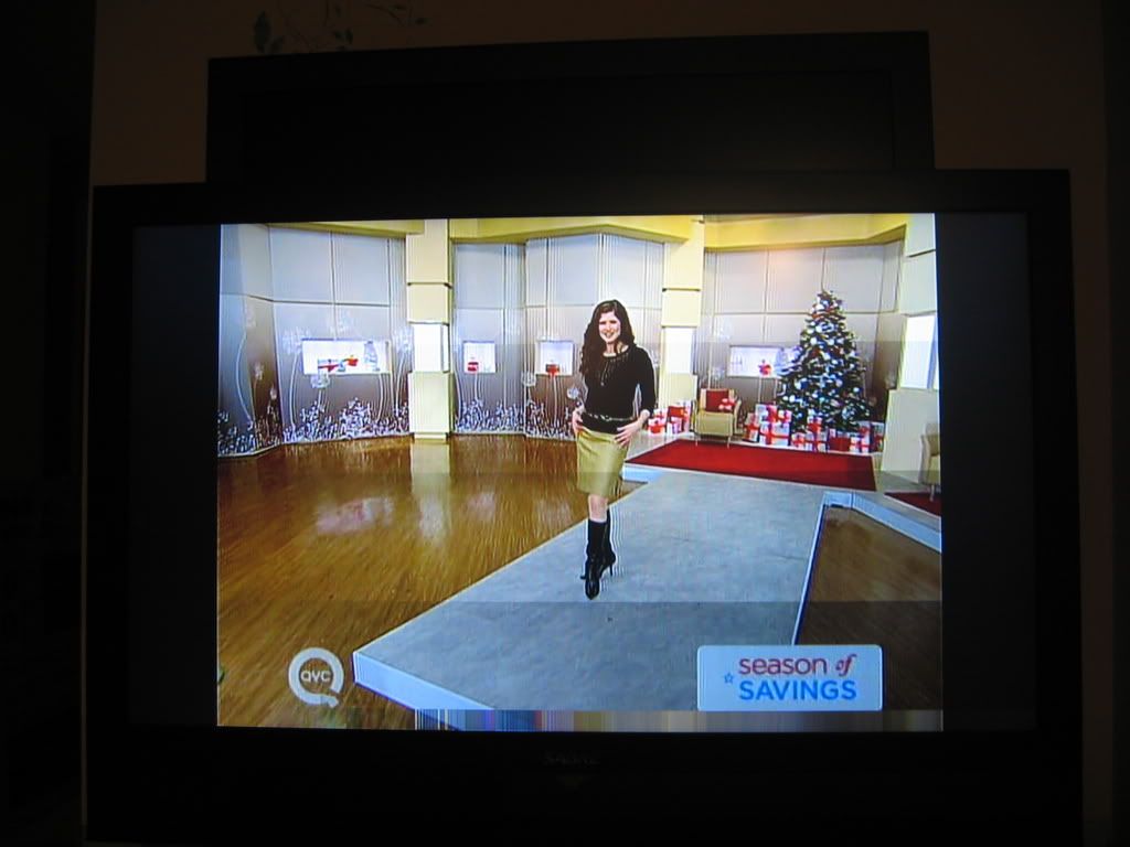

I have a Sabre LCT47PBKA that appears to have some sort of backlight issue. It looks like the screen is broken in to 4-5 panels that go from bright to dark and run horizontally. Can anyone confirm if this is a backlight or LCD panel problem? I can watch the set the way it is, but would like to get it fixed is possible.
Thanks in advance, Jim

Yes, I know they are out of business . I am able to scrape some parts up around the net and am also capable of component level repairs. I'm really interested to know if this is repairable. As in is it a LCD panel issue (not fixable) or a backlight issue (easily repaired).
Thanks again for your help.

Frankly, I have never seen quite this symptom before, Usually a backlight issue does not have defined departure lines like those shown in your pictures. However, due to the fading as it goes across it would seem to be a backlight issue. I have never tried to change any of the backlights even though if you are careful enough it is technically possible. Individual lamps for the backlight are available here: http://lcdparts.net

Ive never seen that before either. But I don't think it's possible that the backlight could cause that symptom.

I've replaced a few backlights in monitors and small TVs. I just ordered a bulb for a 22" samsung that I got from ebay. You can get some good deals on these things of you are handy with a DMM and soldering iron.
I suspect the backlight because it appears dark in the bottom right of the picture and it gets lighter as you move away. That to me indicates 1 bulb is either very dim or out altogether.
Thanks again for your help and input
