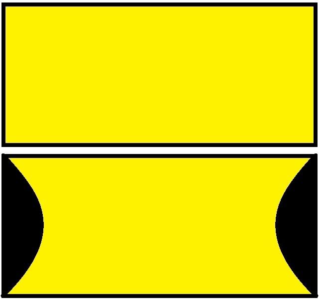

My Sony CRT tv flickers like in the image below.

pincushion
model number?

I've noticed a buzzing sound inside TV, so I opened it and found it's comming from the high-voltage wire. (the one sticking to TV screen).
So I pulled the rubber away (after discharging) and saw electricity passing through air (after turning on TV) (I don't know what this effect is called in English, that's why it sounds stupid).
The wire is "clamped" to the screen. The contact must be bad, because when I moved the wire (with 20cm stick of course), the screen went back to normal and buzzing stopped. But when the wire moves a little, it again goes bad.
So how would you sugject me to make this contact better? Should I sand paper it a bit?
