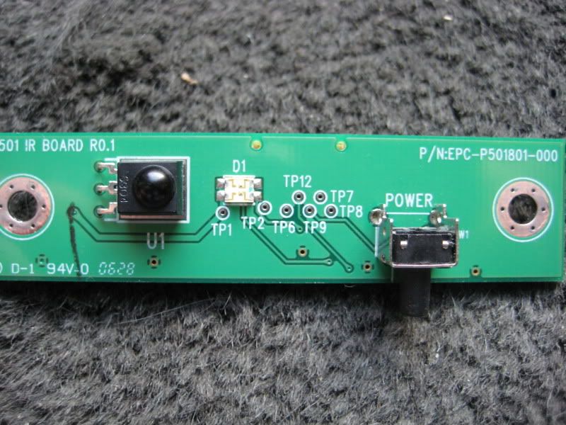

I don't have a power supply - just multimeter, capacitance meter, soldering iron. I have gotten good help from this website & gotten lucky with a couple of my tvs - just hoping to keep the streak going.
The on/off button board cable joins up with the other control buttons board - a cable then runs out of that small board to the main board - see blue connector in pict.
If I jump acrosss the power button with my meter when tv is plugged in I should get a reading - Is this ok to try?

JTS1957 wrote:
Clean up the solder side of board and retake pix.
1) "J1" I presume, goes on to rest of keypad and then to Control board?
2) CNS1 goes to same control board?

PostPosted: Mon Feb 01, 2010 8:35 am    Post subject: new pict of cleaned board Reply with quote
Cleaned up board & new pict as requested
