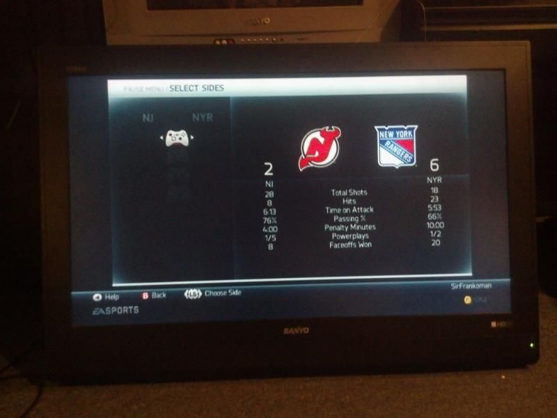

I have a Sanyo Vizon DP42647. I do not have it's original remote, and the only buttons on it are Power, volume and channel controls. The issue is that the colors are a bright, almost neon, green. The rest of the colors seem to work fine.
I noticed if I am playing xbox, the colors are still bad, however when the xbox dims the screen after being idle for a while, the colors are all perfectly fine. Is this an issue with brightness settings and RGB not set properly? If so, how can I change this?

EDIT: Here are two images showing the colors. The first is the green contrast issue and the second is after the Xbox goes idle.

PostPosted: Tue Jul 29, 2014 6:59 pm    Post subject: Re: Sanyo DP42647 Color Issue, Menu Not Available Reply with quote
If you have no menu display then it's MAIN BOARD.If you have menu display and poor color then it is t-con board.
