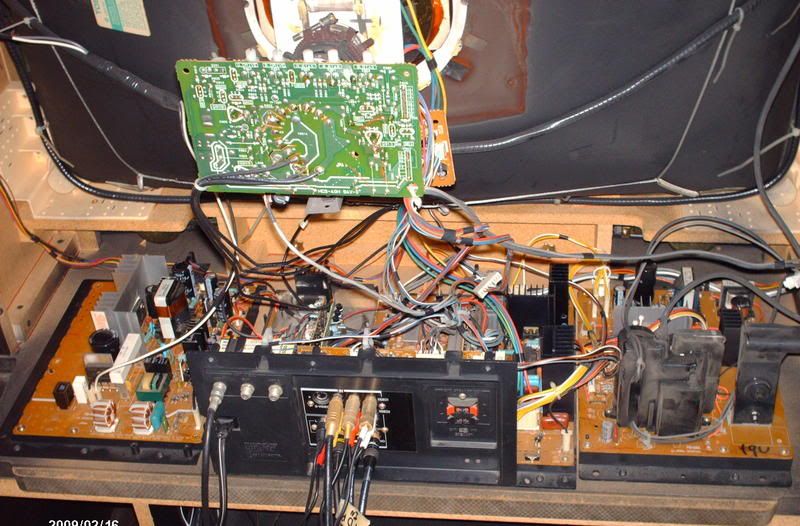

Having a 'cold' start-up issue. CF3572B made in 1993, great picture/sound.
Press the on/off button and it wants to start but goes dead...after that the on/off button does nothing.
If I pull the power plug then plug it back in a few times it will usually start.
Once it's running I can turn on/off all day/night. When is sits off overnight, again no cold start.
This TV has 3-circuit boards. Just for the heck of it I put a hair dryer on the far left board(power supply) for a few seconds and the TV would then start with the on/off button!
Local TV guy replaced 3 capacitors(no fix) and now says anything can be the problem. :roll:
Thanks for any feedback
Please see red circled part attached to heat sink...could this be the problem?
and one more below...

pull the boards out and check for burnt or cracked soldier joints

Also, you've used the heat. Now start using the freeze spray. you can get them from any electronics part store or website.

Question... being that, warmth from a hair dryer on my left circuit board for 15 seconds allows the TV to turn-on via on/off button...can I assume the problem is in fact on that "left" board?
Also...I could almost bet if my home thermostat was set to 75 degrees the TV would also cold start with no problems.

Near each part silk-screened on every board is a location number.
Looking up "CF3572B" in my repair database produced one result for "Intermittant turn on" with the location number/component value previously posted.
That's not to say that this part IS the cause of the failure in your case, but it's something you may want to check.
